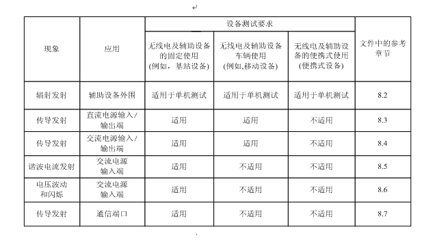

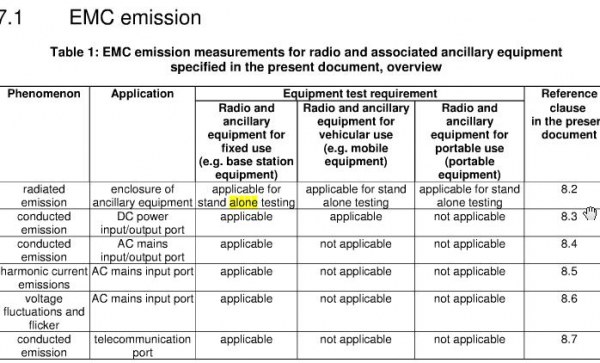

我当时对这个翻译是单机测试[img][/img]

8.2 Enclosure of ancillary equipment measured on a stand
alone basis
This test is only applicable to ancillary equipment not incorporated in the radio equipment and intended to be measured on a stand-alone basis, as declared by the manufacturer。应该就是没有辅助设备的单机设备

zhuyeqing 发表于 2012-12-13 18:33:24 | 显示全部楼层
回复 8# leafcai85
    The applicability of EMC tests specified in the present document depends on the actual type of radio and/or associated
ancillary equipment under test. All tests are port-related EMC tests. For a certain type of EUT not having a particular
type of port or for operational/technical reasons, the related EMC tests may not apply. In these cases, clause 7 of the
part of EN 301 489 series [11] dealing with the particular type of radio equipment provides specifications or restrictions
to the applicability of EMC tests for the actual type of EUT. In the case that the present document is used in a
stand-alone basis it is required that both the decision and the justification not to apply any particular test to any
particular port be recorded in the test report.我目前没有EN301489-11标准 里面有详细的描述
