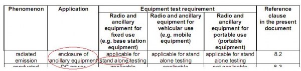

见标准8.2
This test is only applicable to ancillary equipment not incorporated in the radio equipment and intended to be measured on a stand-alone basis, as declared by the manufacturer. This test shall be performed on a representative configuration of the ancillary equipment.
This test is not applicable for ancillary equipment incorporated in the radio equipment, or for ancillary equipment intended to be measured in combination with the radio equipment. In these cases the requirements of the relevant product standard for the effective use of the radio spectrum shall apply.
翻译:
本测试只适用于不包含在射频设备中的辅助设备,并且只做单机测试(我认为是不存在射频设备情况下),测试布置按照辅助设备的典型配置。
本测试不适用于包含在射频设备中的辅助设备或者与射频设备组合在一起的辅助设备(下略)
