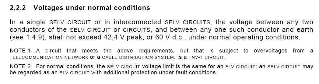

60950中2.2.2,Voltages under normal conditions
In a single SELV CIRCUIT or in interconnected SELV CIRCUITS, the voltage between any two
conductors of the SELV CIRCUIT or CIRCUITS, and between any one such conductor and earth
(see 1.4.9), shall not exceed 42,4 V peak, or 60 V d.c., under normal operating conditions.
