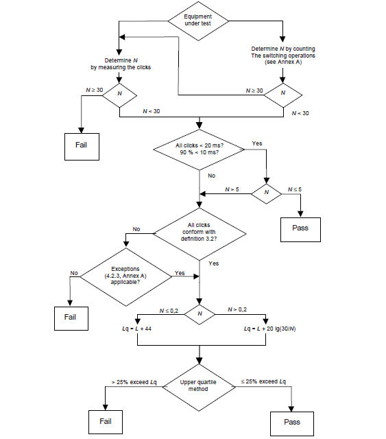

4.2.3 Exceptions from the click definition
Under certain conditions some kinds of discontinuous disturbances are exempted from the definition of a click (see 3.2).
This subclause contains these exceptions which are applicable in combination with subclauses 4.2.1 and 4.2.2 to all kinds of appliances. In Figure 9, a flow diagram shows how to take these conditions into account in the verification procedure.
Product specific relaxations are contained in Annex A, which contains also Table A.2, a list of appliances for which the switching operations are counted, to derive the click rate N.
